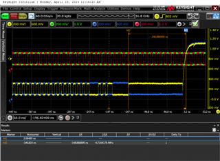

目前我们对应的xx车厂6125平台项目,车机偶现闪屏丢色现象,经过确认是7911问题导致,7911修改后,丢色闪屏现象目前未发现,但是读取941寄存器,仍然有EOT error发生。
TI AFE反馈EOT Error会影响到DSI 视频流中出现数据错误, 从而可能会有闪屏的现象。
LT7911D-0x114-test1 是7911芯片修改DATA TX THS-TRAI后的测试报告(10f 是报NG的),从报告来看是通过了。
但是使用0x114的版本,从log来看,还是有EOT发生,需要帮忙确认EOT error是怎么导致的, 1. 7911测试报告中的参数设定是否合理;2. 这EOT波形是否正常。
In the 6125 platform project , there is occasional screen flicker and color loss phenomenon on the IPC. After confirmation, it is caused by the 7911 chip problem. After the modification of 7911 chip, the color flicker phenomenon has not been found yet. However, when reading the 941 register, there is still an EOT error.
The feedback from TI AFE regarding EOT Error may affect the occurrence of data errors in the DSI video stream, leading to the possibility of screen flicker.
LT7911D-0x114-test1 is the test report of the 7911 chip after modifying the DATA TX THS-TRAI (10f is reported as NG), and according to the report, it has passed.
However, using version 0x114, from the log, there are still EOT occurrences. We need help to confirm how the EOT error is caused. 1 Is the parameter settings in the 7911 test report reasonable; 2. Is the EOT waveform correct .LT7911D-0x10F-test1.pdfLT7911D-0x114-test1.pdf
