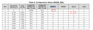

About MODE-SEL pin description in the specification page33,What do H and L mean in Table 6 ?

Hi Ansel,
H and L correspond with high and low, meaning the feature is enabled or not enabled, respectively.
