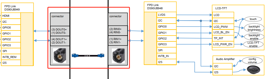

Our products use DS90UB949 and DS90UB948 as shown in the picture below.
To test the hardware, I turned on pattern gen on the 949 and output images at a resolution of 640x480.
I have pulled GPIO_0, GPIO_1 and GPIO_3 high but still can't see any image showing on the LCD-TFT.
The registry dump is shown below.

Do I need to set any settings?
Any suggestions are appreciated!!
