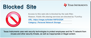

Hello Jason,
sorry but I can't access the link you have provided. Please make sure this is a valid link!
