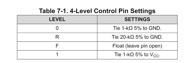

1. I see VIO_SEL and MODE can set "0" "R" "F" "1" in different setting. I think 0 is pull down to GND. F is floating. 1 is pull high to Vcc. What is R here? For '1' and '0', don't we need to place any pull up/down resistors, correct?
    Please see Table 7-1 for the 4-level pin configuration

    1. If we used pin strap mode instead of I2C mode, how can we set VIO_SEL pin?

  • Roy
    You could set VIO_SEL to ‘F’ when in pin strap mode.
    For AEQCFG, I would have both pullup and pulldown options in the PCB design, but initially set it to ‘F’ to adaptively sweep 9 EQ settings.
