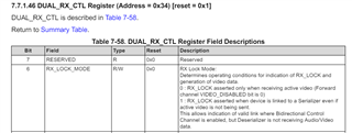

    You can also change the 948 setting  0x34 RX_LOCK_MODE to 1 in order to see lock change without valid PCLK present.
    Logan
  • 948 Set 0x34 RX_LOCK_MODE to 1, the LOCK signal of 948 is still low, what is the possible reason? What about checking those places? Hardware or software?
