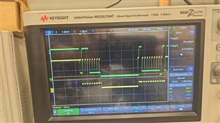

I have a board with 2 TCA9548A chips. One with address x70 and the other with address x71.
Im using a NI USB-8452 as the I2C Master sending the data from my application.
The SCL and SDA pins have a pull up resistor of 4.7kOm to Vcc =3.3V
The application is very simple:
  1. Configure the slave address x70 +1 bit Write,

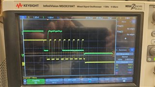

  2. Write a command to switch the channel. For instance, if I want to connect Channel1, I send "x1". I connected the SCL and SDA of CH1 to the scope. As you can see in the image TA CH1.jpg, the yellow signal is the SCL and the green signal is the SDA. This is the expected behavior.
  3. Close the session and the reference.
  4. Stop application.
Problem:

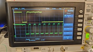

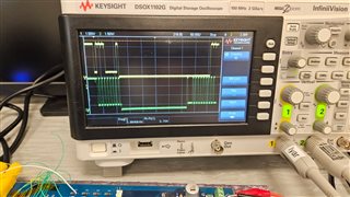

After running one time the above application, I changed the command to "x0" (No channel selected) and ran again the application. To my surprise, I see part of the above signal in the scope (see image TA Ch0 Bad). I expect to see No Signal.
I changed back to Ch1 "x1" and run again the application. I see in the scope the expected data (TA Ch1.jpg). Now, I changed the data to "x2", ran the application and see extra data  in the scope (see image TA CH2.jpg) I expected to not see any signal. If I run again the same application with data "x2", then I don't receive any signal in the scope. This is the expected behavior.

  • The datasheet says in section 8.5.4:
    When a channel is selected, the channel becomes active after a stop condition has been placed on the I²C bus.
    Do you actually generate stop conditions a tthe correct places?

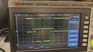

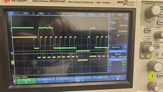

  • Hi Nir and Clemens,
    Here are some more inputs:
    The input to the TCA9548A from the NI USB-8452 is the following:
    I'm using pullup resistors of 4.7k on SCL +SDA + internal 2K resistors from the NI-USB8452. Without the internal pullup 2K resistors it doesn't look nice the signal. However, I'd also tried without the 2K internal resistors.

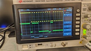

    As you can see from the above images, Im sending the address x70 +0bitW, then it waits from the ACK from the slave and it sends the data "1" to connect Channel0.
    The output looks like this:
    Doing zoom the output address looks like this:
    I ran several tests in the output and what I saw was the ACK coming from the slave changes. Sometimes comes, sometimes with a delay of 300ms, sometimes more, and sometimes less. There is a wrong behavior with the ACK coming from the slave.
