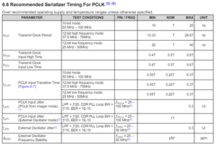

Could customer lower clocks and or rise and fall times with UB913/4 to ease PCB routing and EMC probation?
If so please share which register settings influence this.

  • Hi Frank,
    The data rate from an FPD-Link perspective is determined by the PCLK of the imager being used. In order to reduce the frequency of the line rate, the imager throughput would need to be reduced as well.
    For the rise and fall times pertaining to the 913 device, this would be the PCLK signal and I2C.
    For the PCLK signal, the following specifications must be followed:
    The maximum input transition time for the PCLK signal is 0.3T where T is the transmit clock period.
    I2C rise and fall times for the devices have the following maximum timings:
