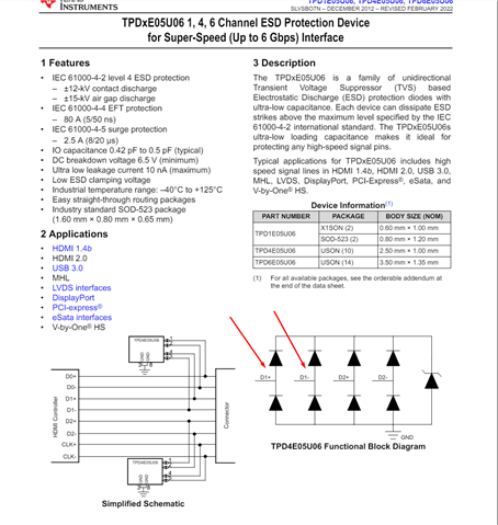

Is there a problem if we connect the direction of + and - in hdmi pairs reversely in tvs? Does + and - in tvs mean something?
Part Number: TPD4E05U06
Hi Adam,
The indications on the datasheet that you are referencing are just recommendations, not requirements. All of the + and - channels on this device are the same internally, so there is no issue if they are connected reversely.
