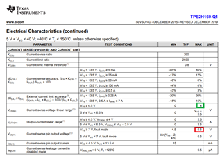

    we don't need to measure the 1.8V but only 1.2V , but in some cases the voltage that can be seen on the pin is 1.8V, will this damage the pin of VDDIO=1.8V?
    it is for the TPS2H160 current sense, in normal operation the max voltage is 4V bit if fault occurs it is 6.5V
    we use resistor divider to bring down the 4V to 1.2V -> meaning 6.5V is also brought down to 1.8V but we don't need to measure it but the adc pin only needs to survive it.

  • HI David,
    Please see section 6.1 in the datasheet. It has our maximums for the pins.
    Glenn
