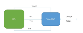

If the TCAN1145 receives a Wake-Up Frame (WUF), through what signal does it wake up the MCU?
WAKE? RXD?SPI?or INT?

Xiaoxiang,
Typically RXD is used to notify the MCU when a wake event occurs. On this particular device, the nINT pin can also be used. The SPI can also be used by polling the interrupt registers. The WAKE pin in an input meant to be used as another wake source, so it cannot notify the MCU of any wake events.

So, if I understand correctly, when using PN+WUF to wake up the MCU, after the CAN receives the WUF signal, it will send the corresponding RXD data to the MCU, thereby waking up the MCU. However, if the CAN does not receive the corresponding WUF, it will not send the corresponding RXD to the MCU, and at this time, the MCU will not be woken up.
Is my understanding correct?

Xiaoxiang,
Yes, that is correct. If there is no indication from the transceiver that a wake was received, and this is done on the RXD pin, then the wake was not properly received. It's important to note that this function will only become available once and if VIO is supplied. So if VIO is not supplied when the wake occurs, there won't be any indication from RXD. In that case, the nINT pin can also be used as a wake indicator.
