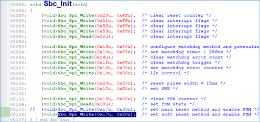

I am using the TLIN1431 well, but after shorting VCC 3.3V and GND, the SBC (TLIN1431) continues to generate a reset signal, so the MCU is not working.
But when I do power on reset, it works fine.
What do you need to add to the initialisation code below?
//SBC init fuction//
(void)Sbc_Spi_Write(0x28u, 0x4Fu); /* clear reset counter */
(void)Sbc_Spi_Write(0x51u, 0xFFu); /* clear interrupt flags */
(void)Sbc_Spi_Write(0x52u, 0xFFu); /* clear interrupt flags */
(void)Sbc_Spi_Write(0x53u, 0xFFu); /* clear interrupt flags */
(void)Sbc_Spi_Read(0x50u); /* clear interrupt flags */
(void)Sbc_Spi_Write(0x13u, 0x40u); /* configure watchdog method and prescalar */
(void)Sbc_Spi_Write(0x14u, 0x63u); /* set watchdog timer : 256ms */
(void)Sbc_Spi_Read(0x14u); /* clear watchdog error count */
(void)Sbc_Spi_Write(0x15u, 0xFFu); /* clear watchdog trigger */
(void)Sbc_Spi_Write(0x16u, 0x00u); /* set watchdog error counter */
(void)Sbc_Spi_Write(0x1Du, 0x80u); /* lin control */
(void)Sbc_Spi_Write(0x29u, 0x20u); /* reset pluse width = 15ms */
(void)Sbc_Spi_Write(0x1Cu, 0xE8u); /* set SWE */
(void)Sbc_Spi_Write(0x18u, 0x00u); /* clear FSM counter */
(void)Sbc_Spi_Read(0x18u); /* set FSM state */
(void)Sbc_Spi_Write(0x17u, 0x30u); /* set reset method and enable FSM */

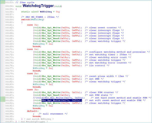

    The Watchdog Trigger (WDI/SDI pin) is being input normally every 20ms, even though it is resetting every 171ms.
    If the reset is still occurring, please contact us to find out how to stop the reset.
    Can you guide me to the register setting code part?

  • Danny,
    The reset phenomenon has disappeared. If you can answer our engineer's three queries below (highlighted in yellow), I think we'll be done.
    The phenomenon of repeated reset after "VCCSC, short to ground" occurred disappeared after changing the "FSM_CONFIG Register (17h) FSM_CNTR_ACT" setting to soft reset (0010b) as described above.

    <Q3>To use the SPI control mode's timeout watchdog (256ms), we input the watchdog trigger to the SBC at 20ms intervals as shown in the code above.
    When I do a watchdog trigger, do I need to re-set the SBC settings every time like the code above?
    Or can I just set the value of "WD_INPUT_TRIG Register (15h) WD_INPUT" to FFh every time I trigger the watchdog? (ex. (void)Sbc_Spi_Write(0x15u, 0xFFu); /* clear watchdog trigger */
    You only need to reset settings after a POR. Your original post seems to have shown that the device was entering fail-safe mode, and then taking the designated fail-safe action, which you had programmed as executing a hard reset (POR). See below for reference:

    For <Q3>, I am wondering if it would be okay to put this code only "(void)Sbc_Spi_Write(0x15u, 0xFFu); /* clear watchdog trigger */" in the Watchdog Trigger function.

  • Dongwon,
    After looking through your code I don't see any errors from the initialization you've chosen. The soft reset change (as we discussed) will help maintain the register settings after a fail-safe mode event occurs. Another approach could have been to increase the FSM counter threshold if desired, but this also works fine since the application of the TCAN24xx-Q1 is so selectable.
    And regarding your clarification to <Q3> above, thanks for helping point out what you meant - I might have originally misunderstood. Since your watchdog is configured to Timeout rather than Window, you are able to service it as frequently as you'd like. There should not be an issue with inserting as many triggers as desired.
    Of course, many applications will implement an interrupt service subroutine or some sort of timed thread to ensure the watchdog is being serviced within the appropriate timeout period. It is of course up to your choice how this would be designed in your system.
