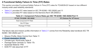

we saw the TCA9539-Q1 functional safety FIT Rate, FMD and Pin FMA document:
TCA9539-Q1 Functional Safety, FIT Rate, Failure Mode Distribution and Pin FMA (Rev. A)
as below table, the Ambient temperature condition is 85deg?
if any suggestion, Please advise me.
