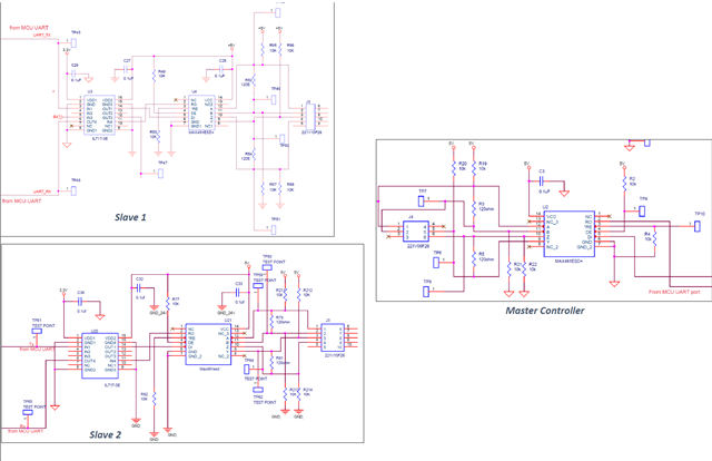

By making use of RS485 transceiver IC MAX491ESD+T, I have designed full duplex network as shown in picture (Schematic). There is one Master and two slaves. I am facing problem where

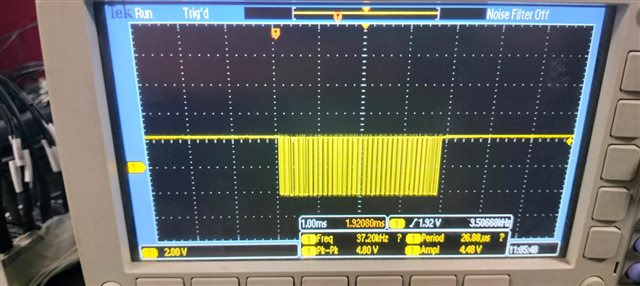

Both slaves are receiving query message from Master but Master is not receiving response to query sent. Up on further troubleshooting, I found that when I keep one Master and only one slave on network then Master receives expected response from slave. I monitored signals on CRO, I found following.

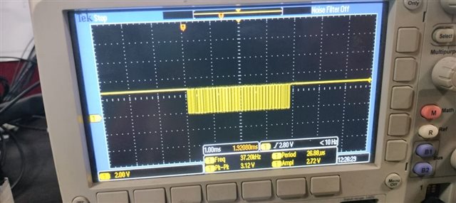

When there is only one slave connected with Master the waveform on Tx+ and Tx- of lines of Slave found to correct (transitioning between +4.8 to -4.2V). However, when 2nd slave is connected in the network making one Master with two slaves combination, I observed following.
The waveform on Tx+ and Tx- lines of slaves to Master controller found to be clipped on negative side thereby not crossing (-200mV as per Receiver's expected voltage threshold). Kindly review my circuits in attached picture and let me know why this full duplex network not working as expected (with one Master and two slaves). Thanks in advance.. Slight smile
