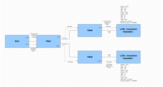

         My configuration is consistent with what you gave, and the pwm frequency on PORT0 and PORT1 is the same, both are 200HZ. We use 941 VCs spliter mode, and the soc dsi packs two signals (VC0 and VC1). The 941 side parses VC0 and VC1 signals to port0 and port1 respectively, and port0 and port1 have the same PCLK, and then connect two 948 channels respectively. Two 948s are connected to two identical screens. The block diagram is as follows:

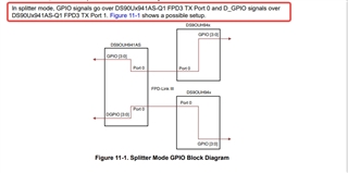

    948-B must be configured to use GPIO2 and not D_GPIO2. On the 948 side, D_GPIO is only applicable when in dual link mode. Can you try using GPIO2 instead of D_GPIO2?
    Splitter Mode Operations with the DS90Ux941AS App note: Link
    Jack
  • Dear jack:
        But I have learned that port1 of 941 can only use D_GPIO passthrough.And the actual experiment is also the same, port1 of 941 cannot pass through GPIO signal, only port0 can.
  • Hi Loki,

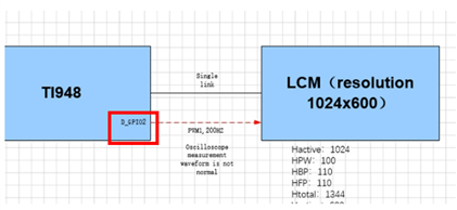

    I do not disagree with the setup of the 941. The setup of the 948-B is where it does not match the app note. The 948-B is currently using D_GPIO2 (Pin 17) as indicated in the diagram. The 948-B needs to use GPIO2 (Pin 10) instead according to the diagram in the app note. Splitter mode is a special configuration for the 941 where the D_GPIO signals on the 941 are routed to the GPIO signals on 948-B.
    User diagram:
    App note:
