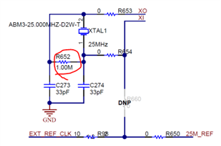

I am confused the Resistor value of R652 is 1Mohm.
Is this a mistake? ABM3-25.000MHZ-D2Y-T doesn't need such huge resistor.

Hi Kei,
This 1M ohms resistor are used to margin on start up time of the crystal. It is optional and not required for customer's resign.
