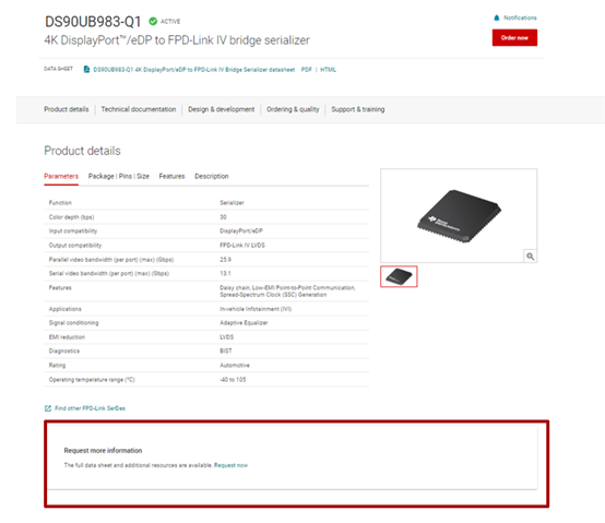

Part Number: DS90UB983-Q1
The video output interface of SOC is HDMI.
Can I use DS90UB983-Q1 for serializer?
Is there any technical documentation and configuration information?
The DS90UB983 can only process DP input. For HDMI signals, the DS90UB949 serializer can process HDMI input. Technical documentation for the 983 can be accessed by using the request link on the product page.
