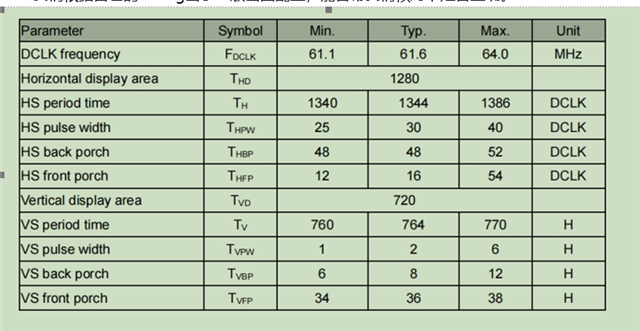

Hi expert,
my customer do the display project, they use DS90UB948, they want to test the pattern, but the display is black screen.
could you help review the customer's config:

  • Colt,
    First of all, what are these settings for? They don't seem to be PATGEN related and I'm even wondering if these are 948 settings or settings for a serializer device??

    948 can't generate timing which falls within this spec directly. You would need to use a serializer PATGEN paired with 948 to generate timing within this spec. The closest timing you could generate to this spec directly from the 948 would be a PCLK rate of ~70MHz. The below settings would set ~70MHz PCLK with the nominal video timings:

    Keep in mind those are settings for the 948 PATGEN. If you are trying to generate PATGEN from a SER device attached to 948, then you will need different settings.
