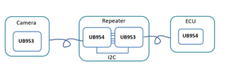

Hello Hamzeh,
Thanks for your interest. Could you provide the products for repeater?
Hello Omer,
a repeater is a design that you can make and use between your camera and your ECU as following:
