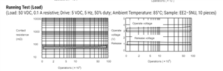

I'm trying to control a bunch of twin coil latching relays, part number EE2-3TNU. Will the TCA6418E be able to supply enough current to trigger the relay?

Is this spec describing the operating voltage and release voltage, is this similar to the turn ON voltage and OFF voltage of the relay?

I would think the sink and source current would be enough, but my knowledge of this signal relay is not good. Can I have help in understanding what spec I should be looking at?
