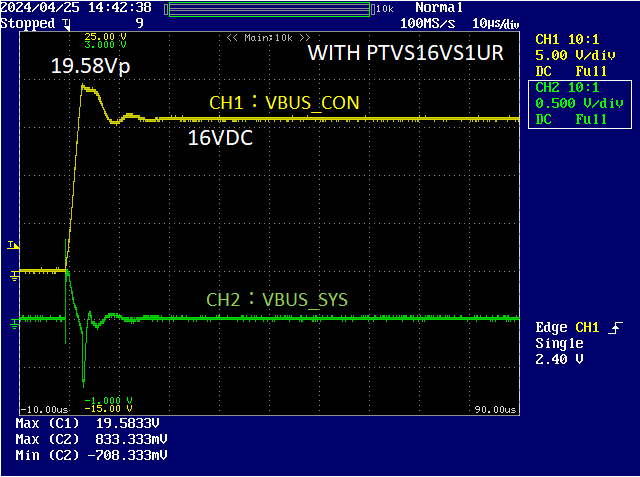

Even with a TVS diode, ringing of 19.58 Vp (at a short-to-battery of 16 VDC) is occurring in my hand.
I want you to guarantee this.

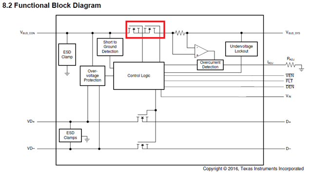

    And, the NMOS (red frame) in the VBUS line, please tell me if there is any information on the withstand voltage (absolute maximum rating) between each terminals.
    Okuyama

  • Hello Okuyama,
    Thank you for waiting. I now have a short to battery tester I can use for the bench test, so I will share my test results this week.
    And I do not have any other data besides than the abs max ratings from the datasheet.

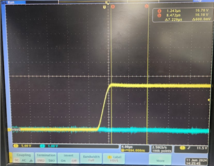

  • Hello Yuki,
    I just finished the bench test using the TPD3S716-Q1EVM (specifically, using U1, USB1 port, and USB2 port). First, the scope capture below shows when 5V was supplied to VBUS_SYS and 17V was discharged to VBUS_CON from a 22,000uF capacitor. The yellow signal is VBUS_CON and the blue signal is VBUS_SYS.

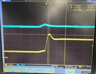

    The scope shot below shows the same test but when VBUS_SYS is 0V.
    The scope shot shows that without voltage on the VBUS_SYS pin, there is no ringing.

  • Hello Seong,
    Thank you for your reply.
    So, the ringing voltage of the below waveform is generated, is there TPD3S716 problem in terms of guarantee?
    I would like this waveform to be electrically guaranteed.
    For example, if the two NMOS in the TPD3S716 are each rated at 18V, what if the waveform above is a guaranteed voltage?
    Okuyama
  • Hello Okuyama,
    Yes, it is guaranteed. The short-to-battery protection isolates the internal system circuits from any over-voltage conditions at the VBUS_CON.
    BR,
    Seong

  • Hi,Seong,
    What would happens when the VBUS_CON voltage exceeds 18V when the device is unpowered ?
    Ringing of 19.58 Vp (at a short-to-battery of 16 VDC) was occured in my hand when VIN and VBUS_SYS are 0V(GND).
    Okuyama
  • Hi Yuki,
    This could potentially damage the device.
    BR,
    Seong
  • Hi,Seong,
    I would like to know why the voltage that the VBUS_CON can withstand changes when the device is not powered(VIN= 0V or below UVLO) and when it is unpowered (VIN= over UVLO).
    If the VBUS_CON exceeds 18V when the device is unpowered (VIN= 0V or below UVLO), what will happen and where will it damage? And why doesn't it damage when the device is powered?
    Is it two NMOS that will be damaged?
    For example, if two NMOS are each rated at 18V, I think the voltage between VBUS_CON and VBUS_SYS(0V) can withstand 32V (18V×2) ringing.
    Okuyama
  • Hello Okuyama,
    The bottom line is that the absolute maximum rating should never be exceeded. When there is a short-to-18V-VBAT condition on VBUS_CON, our validation tests conclude that ringing up to 40V can be withstood, but only for a short period of time as shown in Figure 6-10.
    What's important to note is that this is guaranteed only under the same conditions, where the device is powered so that the overvoltage is detected and all of the recommended operating conditions are met. Therefore, ensure that your system always follows the recommended operating conditions. Otherwise, the device could be damaged permanently and will be inoperable.
    Exactly what will all get damaged and the degree of damage is unpredictable as it will vary case-by-case. And more importantly, I am unable to answer your questions as there is no damage characterization data I can refer to, or do myself.
    BR,
    Seong
