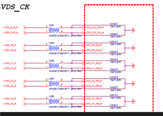

SN65DSI83: Question about capacitor value on VCORE(31) pin
Part Number: SN65DSI83
Dear TI experts,
My customer tests their own PCB with SN65DSI83.
During tests, they found that the capacitor value on VCORE(31) pin should be set to 0.1uF, then the display operates normally.
But If they change the value of this capacitor to 0.1uF (which is recommended in datasheet) the display is not operates properly.
So I am asking that this 1uF value will be okay for SN65DSI83 and other schematic.
Or should we modify something for using 0.1uF capacitor value?
Please check this issue. Thanks.
