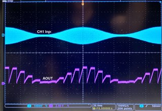

Out of the box, I followed the EVM User's Guide. I didn't see anything on the TCLK or INT/HOLD. I checked all the jumpers were installed on the the TPIC8101 side. I posted to E2E. I was referred to this thread. I downloaded and successful flashed the firmware posted here but there is still no TCLK and INT/HOLD. I verified that the TPIC8101 board is functioning by removing the TIger board and using external signals on the TPIC8101 to successfully output from the OUT pin.

Found the issue. The TIger board was missing a jumper on the 3V/5V header:
I now get a AOUT:
