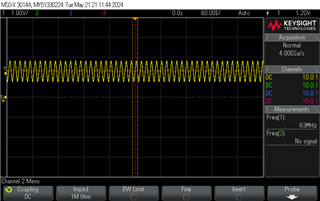

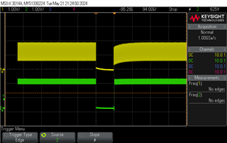

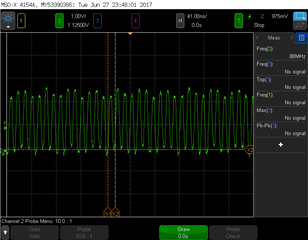

  • Hello
    Attached the pclk (Yellow) and the lock (green) signals when there is no lock ( lock is blinking)
    Regarding the registers, I work on it.
    Roi
  • Hi Roi,
    Would you be able to do some explanation of this material? Is the yellow PCLK in the top right the signal from the deserializer or the serializer? Is there any change to the PCLK signal input to the 913?
    Zoe

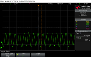

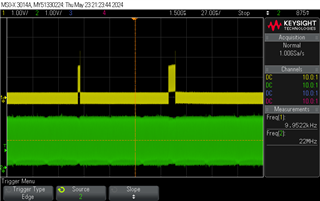

  • The all picture is from the Deserializer side.
    Attached the register dump.
    SER_DES_reading.xlsx
    Below is the PCLK from Serializer:
    PCLK_SerializerGrren(PCLK_Serializer)-Yellow(PCLK_Deserializer)
    When the lock is fail the ISC is not working.
    Roi

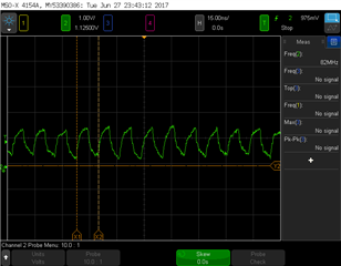

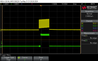

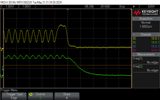

  • Hi Zoe
    Attached the pclk on 914 and 913.
    Roi
  • Hi Roi,
    It's a little unclear to me what the exact issue is being seen here.

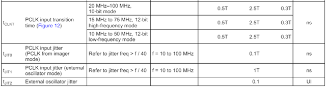

    What is the difference between the image in saturation and live video? When the image sensor is in saturation is the image sensor on? In live video, is the lock pin still seen to toggle?
    Would you be able to check the PCLK input is matching our specifications during this state? These can be found below:
    Please ensure the scope is properly grounded during these measurements as without this may result in some offset/noise.
    Can you provide measurements for the power pins on the 913 and 914 for voltage and noise?
    Additionally, would you be able to share the 913/914 layout? This will help us check is layout guidelines are being followed.
    Zoe
  • Hello Zoe
    Thanks for your suppott, The board is working, the problem was on the power pin of the image sensor.
