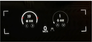

                     TX:DS90UB934
                     RX:DS90UB926
                    1.When TX transmits image signals to RX, there will be small noise in the red box as shown in the picture below. What may be the cause?
                    2.When the TX(DS90UB925) changes to a different model, there will be no problem with the following small red box noises
  • Hi Hung Yu-chuan,
    TX:DS90UB934
    Did you mean DS90UB925?
    So, this occurs only on one 925 unit? how many different 925 units were tested?
    Does it occur repeatedly, continuously after power up every time?
    Does doing a Digital Reset on the 925 ( register 0x1[0] = 1), clear the issue?
    Also, are they just two spots or is it along the whole horizontal line?
