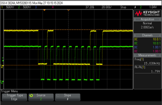

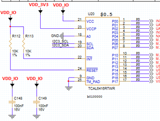

I have a problem accessing the device when VCC is 1.8V and VCCP is 3.3V. See the schematic below:
When VDD_IO is 3.3V there is no problem, When VDD_IO is 1.8V there is no ACK from the device.
Any ideas?

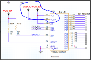

On the same I2C bus I have a second part at address 0x21. See schematic:
For this part when both power rails are 1.8V it is OK.
Can it be related to the PU resistors value? On my board it is 2.2K.
The PU is OK. I have no explanation.
Does it start working after you've forced a low pulse on /RESET?

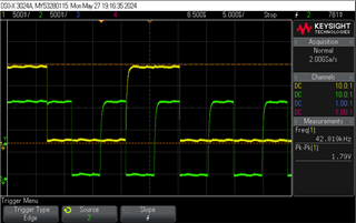

Hi Noam,
To Clemens points, I looked at the previous responses and see no issue with the implementation. The i2c waveforms, schematic, and voltage to VCCI and VCCP looks good.

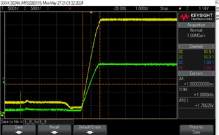

1.75 V.
Does communicating to the second IO expander with 0x21 work with VCCI = 1.8V and VCCP = 3.3V or are both IO expanders not working?

Resetting the part didn't help. I also kept the reset signal low during power up and still it didn't solve the problem.
So, I changed VCCP to 1.8V i.e. connected it to VDD_IO, and now I can see the part on address 0x20.
Can it be related to the way VCC and VCCP ramp up? There is nothing about it on the datasheet.

No power sequencing requirements between VCCI and VCCP for this device.
