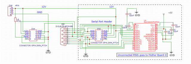

  • Hi Bobby,
    Thanks for your support.
    Reference schematic enclosed.
    From SMPS 12V supplied to Mother Board, from Mother Board 12V supply is connected to serial port header Pin8 - CTS and same connected to PIN4 - RIN1 of MAX3243.
    PIN4 - RIN1 is got damaged, so no communication between Mother Board and External pheripheral.
    We need to know if 12V is applied continuously to PIN4 - RIN1 of MAX3243 whether IC will get damage?, if so please let us know.
    Siba
  • Hi Siba,
    The top marking shows the device was made from December of 2022 and I was able to find it in our system.
    I checked the schematic, I don't see an issue (I'm assuming the note below the IC that states pins are not actually floating is correct).
    Again. the device is rated up to 25V on the RS-232 receiver pins as the absolute max value it can support. I don't think this is where the damage is coming from unless the 12V signal somehow shoots above 25V.
    What is the damage signature? (How do you know this pin is damaged?)
    Are there any specific tests you've run on this pin? (Is it shorted to GND/VCC/adjacent pin?)
    Did you perform a curve trace and find it doesn't match the other pins or a correlation unit?
    -Bobby
