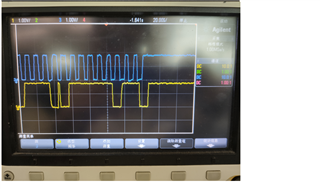

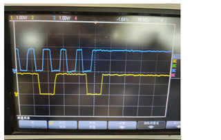

my customer use 935 pair with 960, When using i2c to write to the 935 register, there is a high probability that i2c will fail to write, and after testing, it was found that when writing 0x7d to the 0x7 register of 935, from the scope analysis , found that the slave address 0x34 has a ack, the register 0x7 has a ack, and the register value 0x7d does not have a ack. could you help review this problem.

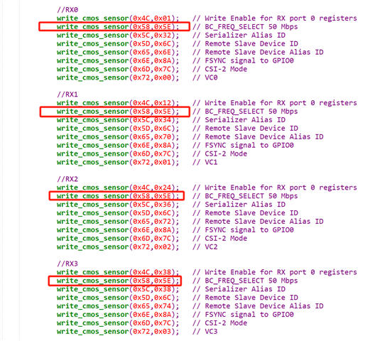

    How is the DES reg 0x58 configured? i.e. with which value?

    You are trying to write the SER register 0x07 with the value 0x7d? is that right?
            yes, All registers have a probability of random write failure (when writing i2c, the first two acks are answered, but the third ACK is not answered)
            The 0x58 register is configured as 0x5E
  • Hello Lin Zhang,
    Does that mean, you can communicate with the image sensor without any problem, but when communicating with the SER sometimes it works and other times not. Is that correct? If that is the case, please check the IDx pin configurations on the SER (voltage and resistors). Also, make sure the I2C voltage on the board matches with settings in the SER reg 0x02[0].
