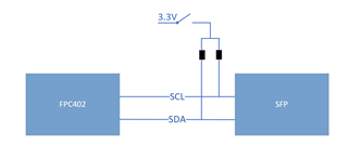

We are using FPC402 as SFP56 controllers.
And we have a hot plug design on SFP56: 3.3V on SFP is disabled in default and will be enabled after plug in( including PU on SCL/SDA ).
So after 3.3V power on, FPC402 downstream port's SCL will be stuck for 700ms. It's over 300ms (known as SFF-8431, t_2w_start_up)
Any explanation from your side? Is it reasonable on FPC402?
BR
Zhigang

  • 1) Yes, this is an issue reported by our SW. Because 300ms expired and blocked initial sequence. But after 700ms, we can access downstream port
    2) Yes, EN pin is default on during plug in and SW initial
    3) based on answer of Question 2, i think no difference
    Any other suspecting?

  • 1) Yes, plug in optical module and power on 3.3V. Then wait 700ms to access module
    2) Do you mean FPC402 reset? We are thinking the work around to have port reset between 3.3V enable and initial optical module. But Linux Kernel team isn't happy with that
    Besides, we have tried permanent 3.3V PU on SCL/SDA. There is no such issue. Any more idea here?

    Since permanent 3.3V PU on SCL/SDA works, this means when I2C interface is exercised there is no pull up. This means we should enable PU much earlier within this 700ms time window.
    Regards, Nasser

  • Hi Zhigang,
    Does FPC402 AND SFP share the same 3.3V supply? I mean when you turn power on the SFP on hot plug the power gets turned on the FPC as well?
    Since permanent 3.3V PU on port side I2C works, it means somehow FPC device is not able to get acknowledgement and it times out. Is it possible to put scope on I2C signals to see what is occurring or what other entities could be driving the I2C lanes? There is a timer within the part that sets up the I2C stuck time out. Your FPC software driver could be setting up this register.
    Regards, Nasser
