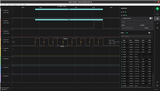

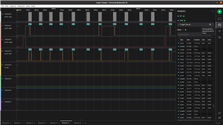

I have connected the STM32 and TCAN4550EVM and want to enable CAN FD communication. However, there are no signals being transmitted on the CAN H/L lines. How can this be resolved?
The logic analyzer detected multiple instances of 0x81 and 0x89 on MISO. How can this issue be resolved?
Where can I find information about the error messages returned on MISO?

I repeated TCAN4x5x_Device_ClearSPIERR() twice because there was an issue with reading one set of data from the logic analyzer.

  • Hello Hsinyu,
    The Global Error (GLOBALERR) bit is set when one or more other bits are set and will be cleared when there are no other bits set.

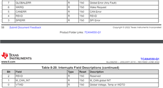

    The value of 0x81 means the Global Voltage, Temp or Watchdog (WDTO) bit (VTWD) has been set.  Can you measure and verify all of the voltage rails are at their proper levels? VSUP, VIO, and VCCOUT?  Also, can you measure the voltage on the INH and RST pins?
    The value of 0x89 means that the SPI Error (SPIERR) bit has also been set in addition to the VTWD bit.  Reading register 0x000C will provide more information on why the SPIERR bit is getting set, but it usually comes down to an incorrect number of SPI clocks between the chip select signal transitioning low and then high.

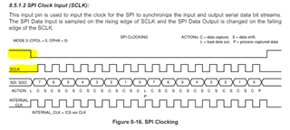

    The SCLK signal appears to have a falling edge after the initial chip select transition low at the beginning of the transaction which may be the problem.  The datasheet shows the SCLK should be low initially so that the first clock edge is a rising edge.

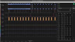

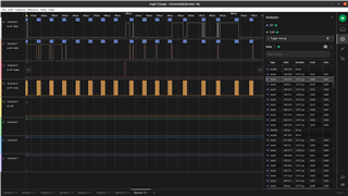

    1.I use AHB_READ_32(REG_SPI_STATUS); to read hoooc
    Based on the LA display, does 0A000000 indicate issues with bits 25 and 27?
    27: Entry written to the internal error log
    25: Read FIFO empty for the first read data word to return

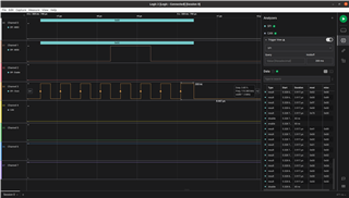

    2. I found an issue with the SPI clock: each group of clock pulses normally has an interval of 250ns, but there randomly appears a pulse with an interval of 333ns.

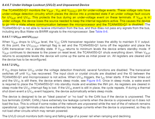

  • Hi Hsinyu,

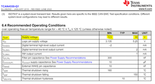

    I think your primary problem is that the VSUP Supply Voltage is too low.  This voltage must be greater than 5.5V and you are only providing it 4.6V which will cause the device to be in an under-voltage state.
    Please provide a larger supply voltage and see if the SPI communication issues are resolved.
    The SPI signals are all edge based and a slightly larger clock pulse width should not cause a problem as long as the sample point of the data bit is not affected to a point where the setup/hold times are violated such that a bit error would occur.

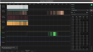

    Also, after I switched to 12V, I noticed that the INT pin and MISO were still sending messages after the previous communication ended.
    Could it be that my INT pin is not configured correctly, causing me to miss messages?

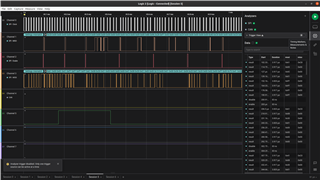

  • Hi Hsinyu,
    The SPI Error (SPIERR) bit appears to be getting set and is indicated as bit 3 in the 0xC8 Global Status Byte that is returned on the MISO line on every SPI transaction.  This means there is something incorrect with the SPI.  If a SPI error occurs on a Write, the TCAN4550 will discard that transaction and the register will not be updated.  If a SPI error occurs on a Read, then the data returned may be incorrect.
    Your Logic Analyzer plots have too many bits for me to see what may be incorrect with them.  Is it possible to just capture single read and write transactions with enough resolution to see if the placement of the clock edge relative to the data?  Ideally can you capture a single SPI transaction that shows the chip select going low and then high again that fills the entire window?

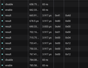

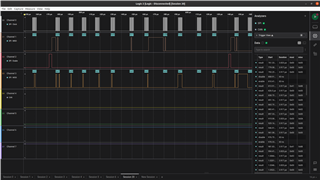

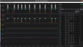

  • Hi Jonathan,

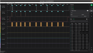

    Based on the LA display, I read 0x88 0x00 0x00 0x00 0x00 0x02 0x00 0x0A 0x00 0x00 0x00
  • Hi Hsinyu,

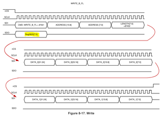

    The chip select signal is remaining low after the SPI transaction should have completed.  The TCAN4550 works on a 32-bit "word" or 4-byte system and there must be an exact number of clock cycles to prevent a SPI error.
    If the clock cycles seen is not a multiple of 32, then a SPI error will occur.
    Also, if the number of clock cycles does not match the number indicated by the Length field, then an SPI error will occur.  A Single register read or write transaction requires 64-bits.  The first 32-bits is from the Header word that contains the R/W operation code byte, the Address bytes, and the Length field.  The second 32-bit word is the Data field.  Together this means there should be 64 SPI clock cycles for a SPI Read or Write with Length field = 1.
    If multiple consecutive registers are to be read or written, then there will be an additional 32 clock cycles needed for each additional word indicated by the length field.  For example, there are 96 clock cycles needed when Lengh = 2.
    SPI Clock Cycles = 32 + (Length * 32)
    You will need to adjust the driver so that the chip select transitions high after the proper number of clock cycles.
    Jonathan
  • Hi Jonathan,
    Thank you for your help.
    The issue was indeed because the number of clock cycles did not match the number indicated by the Length field. The reason was that I separated the read register into individual read and write operations, which resulted in three extra clock cycles.
    Now the CAN communication is working properly.
