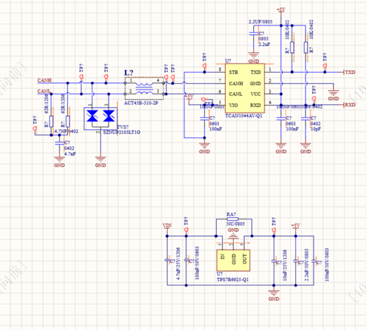

Hi team,
Could you please help review the schematic and give some suggestions? Many thanks.
ivy
  • Hi Ivy,
    Here are a few comments:
    I noticed that RXD is connected to +5V in two locations. You may want to double check if the first capacitor on the RXD line was intended to be the decoupling capacitor for +5V (I believe this may be the case since this capacitor is the recommended 100nF decoupling cap per the datasheet). You can also consider adding 0-ohm bypass resistor placeholders on the RF choke in case you would like to depopulate this. The bus termination is recommended to be 120 ohm.
    Regards, Amy
