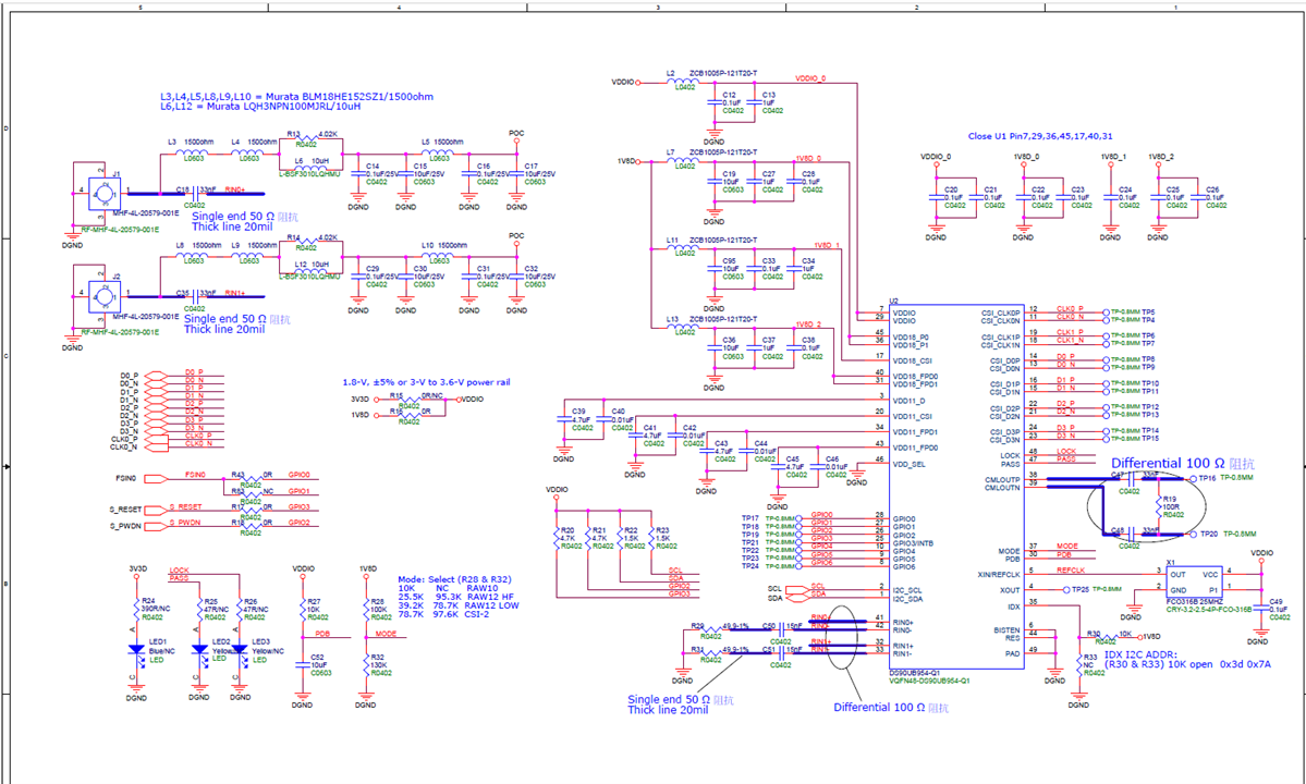

    Can you help confirm whether the design of the 954 peripherals on the circuit diagram is correct.
    C15,C35,C50,C51,R29,R31
    Overall, this schematic looks good. The chosen AC capacitors (C18, C35, C50, and C51) are proper for operating in CSI Synchronous mode, which is what the mode pin is strapped to. As long as the mode is not overridden with the registers, these capacitor values are not an issue. A few minor notes on the schematic:
    • The 1.5k pull-up resistors on the I2C line are slightly low, however, if there is no indication that I2C communication is failing this is not a concern
    • Recommend verifying that the chosen oscillator and ferrite beads on the power pins meet the requirements in section 7.4.4 and 8.2 respectively
    • The third inductor in the PoC network has a different placement than the data sheet example network

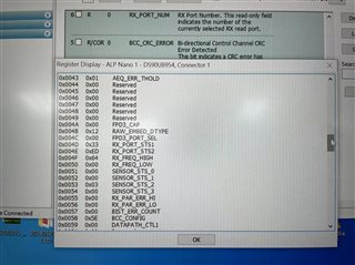

      When the image was abnormal, I checked the TI954 register value.
    The register 0x4D is 0x03 --> 0x33.
    How can I check this issue?
    Register 0x4D = 0x33 indicates that lock has been lost at some point since the last read of the register and a CRC error has occurred on the forward channel. From the screen shot register 0x4E = 0xED indicates that several errors are occurring (unstable line length, line length and count change, encoder errors, and CSI errors). It seems like the data on the forward channel is being impacted, this could be due to the cable quality/connection, an external interference, or even the PoC network.

    • The 954 schematic shows that both RIN ports are being used, are both 953s receiving the same resolution (2560*720@30fps)?
    Can you also share a full register dump? In the previous screenshot there was a lost lock and several errors logged.

    • The 954 schematic shows that both RIN ports are being used, are both 953s receiving the same resolution (2560*720@30fps)? -->1920x1080 raw

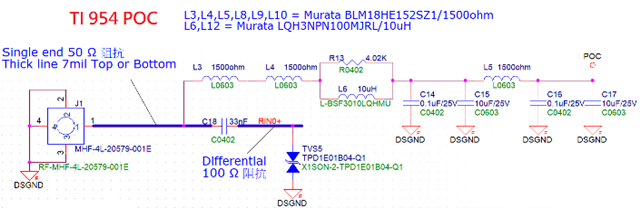

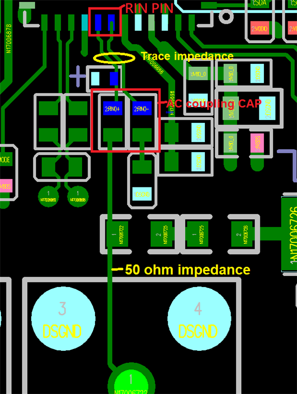

    follow as ,  AC coupling caps to RIN pins traces the impedance value is differential 100ohm or single-end 50 Ohm?

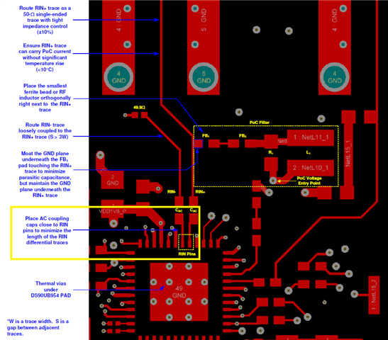

    The RIN traces should be loosely coupled with 50 Ohm impedance on each trace
  • Hi Sir,
        What is the impedance (ohms) of the PCB trace from the RIN PIN to the AC CAP?  Differential 100 ohm or single-end 50 ohm?
  • The RIN traces can be routed as 100 ohm impedance differential traces up to the AC coupling capacitors. After the capacitors, the traces must be routed as 50 ohm impedance single-ended traces.

     Thanks for your reply. Can you help check the inductance on the Poc ?
    L1~L6 Is the inductance value correct?  1500ohm = Murata BLM18HE152SZ1
    The frame loss problem has not been solved yet.
    These inductors appear to be the same listed in the datasheet examples and have an appropriate inductance. Note that the 50ohms impedance needs to be maintained on the connection between the high speed trace and POC as well.

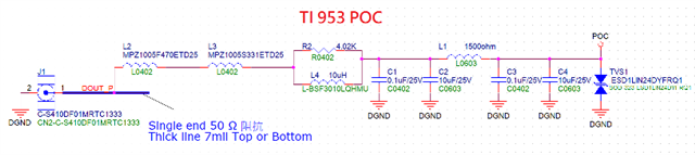

  • Hi Sir,
     The inductance values ​​on the 953 POC is 47ohm/330ohm/1500ohm and 954 is 1500ohm POC are different, will this affect the FPD_LINK transmission data?  Will it affect the transmission and sometimes the frame data will be dropped?
    Andy
  • The PoC network does not have a specific number of inductors or inductance value that must be used. There are various inductors that can be used to create a PoC network, the datasheet provides a few examples. Any changes to the inductors of those examples could impact how the network performs. What is important to the FPD-Link devices that utilize the PoC network is that there is a high impedance and low insertion and return loss on the channel. The examples have been tested to meet these requirements, so any modifications would need to be validated to ensure that there is not any changes to the performance. The inductor vendors are able to provide more details on how different inductors may behave in a network as they are the ones who designed the PoC networks. However, you mentioned earlier in this thread that removing the PoC network did not have any impact on the system so the PoC issue does not seem to be related to any issues in the system. Is this not actually the case, has something changed?
