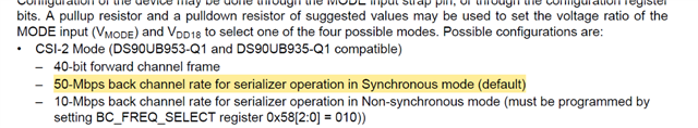

1. 960 mode strap pin is CSI-2 mode. 953 mode strap pin is mode 0 CSI-2 synchronous mode. But after power up, the 960 0x58 register bit 0-2 default value is 010: 10Mbps.

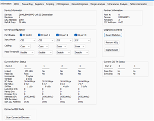

-Why the default frequency is 10Mbps? Datasheet says the default is 50Mbps for synchronous mode. Would you also test on EVM and verify?
2. 960 mode strap pin is RAW mode. 953 mode strap pin is mode 0 CSI-2 synchronous mode. Customer firstly change 960 0X6D register bit 0-1 to 00: CSI-2 mode. They find 0x58 register bit 0-2 default value is 000: 2.5Mbps.
It cannot lock before they change it to 50Mbps. Is it normal? Would you also test on EVM and verify?
