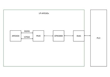

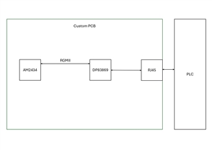

Hello experts,
I'm working on a custom board that uses AM2434 with DP83869 PHY for industrial ethernet application.
LP-AM243x reference design is being used as a starting point to design the new board.
A multiplexer (TS3DDR3812RUAR) is used on the LP to connect the CPSW or PRG RGMII pins of the MCU to the PHY.
The custom board is going to use the ethernet for industrial ethernet applications only (profinet, ethercat, ethernet/IP, modbus TCP/IP...);
the question is: do I need to use a mux to connect both the CPSW and PRG RGMII pins to the PHY or is it sufficient to connect only the PRG RGMII pins?
Thank you,
Andrea
