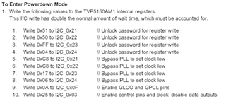

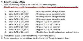

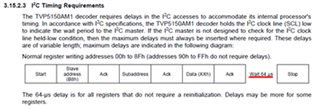

I have got a question from customer regarding to TVP5150AM1’s PowerDown sequence .
In the document of “tvp5150am1_PowerDownMode.pdf”it is said that the I2C has double the wait time, does this mean that the wait time before the stop condition needs to be 128us? were it is written 64us in 3.15.2.3 Timing Requirement.
