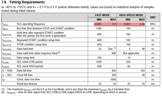

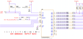

In our design, we observed that the SCL rise time from the I2C Master to the TCA9548A-Q1 is not a fixed slope.
The measured minimum is 165ns, and the maximum is 288ns.
Is this because the different number of TCA9548A-Q1 output Ports enabled increases the capacitance (Ci)?
How do we calculate the input capacitance of SCL?
