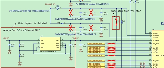

Now if we want that the supply is not derived from a low power LDO directly from VBAT and this pin is directly connecte to REGOUT_3V3 as below:
Is it feasible?If no, what is the reason for that?

Hi Rata,
Is sleep mode being used? If so, always on Vsleep supply is required. Else, Vsleep can be connected to VDDA as shown in SNLA389, section 2.
