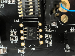

It seems CAT24C08WI-GT3 is not fit to our EVM. can you find the EEPROM pin to pin to AT24C04A , so I can try on our EVM.
brian
Hey Brian,
Unfortunately CAT24C08 does not come in a PDIP package. Is it possible to use wires to connect the pins to the pads in order to test the device?
