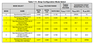

    We would be able to use the UB971 with the UB954 but only in FPD3 mode of the UB971. This could be used in sync mode or non-sync mode with the UB954.
    Please note that the link rate will be lower when the UB971 is paid with a UB954. The full link rate of 7.55Gbps (6Gbps CSI BW available) is supported when paired with a UB97x deserializer in FPD4 mode.

    If the MIPI CSI-2 rate is 1106Mbps per lane we would need to use 971 with a FPD4 deserializer. The FPD-Link ADAS format has 40 bit forward channel with 32 bits of data, in this case the 4.16 Gbps forward channel could not support this data rate. We would need a FPD4 SER/DES for this CSI payload.

    The UB971 is compatible with the UB954, however not at the full rate of 7.55Gbps. The UB971 would need to be configured into FPD3 backwards compatible mode shown below:
    For operation at 7.55Gbps would 4 ports be needed or only 2 ports? If 4 ports are desired with a DPHY output U9702 could be used. For 2 ports with DPHY output UB9722 could be used.
