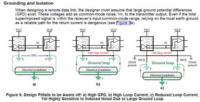

1. Do we have any design guide or materials that cover below topic in more detail?
2. Assuming that there's no termination resistor,

  • 1. Figure 9 just says that when ground differences exist, you have a choice between a high loop current or higher common-mode noise.

    1. That is the information we have on ground potential differences and how they apply to RS-485 systems. When we do trainings for RS-485 that is the information we share. There really isn't much more to share beyond the trade-offs of the ground routing in the system - if you have any more specific questions I would be happy to take a look at them.
