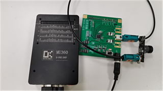

    My test tools:

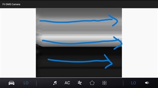

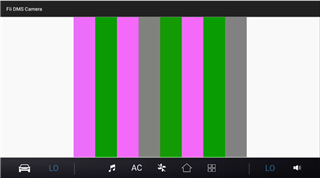

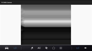

    test result:

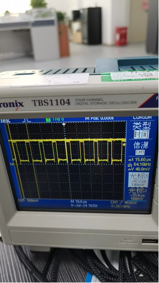

    MIPI waveform output by TI638, all 4 Lanes have waveforms:

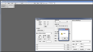

    My tool setting:
    My tool reg. setting:

  • Hello Carter:
       I also attached customer tested 635-> 638 the output display abnormally (white -black screen as below).  need your teams help give us which register tuning guideline we can fixed the issues. thank you
  • Hello Lee,
    Is this problem occurring when a specific script provided above is run? I will compare the provided scripts with the script I provided at the beginning of the thread and note any differences by the end of the day tomorrow.
    Carter
  • Hello Lee,
    After reading through the provided scripts I have noticed several discrepancies between them and the script provided at the beginning of the thread.
    Please make sure to follow the order of execution used in the script provided:
    Select Port 0
    Setup any Serializer Aliases
    Enable I2C Passthrough (Some scripts do not enable this)
    Configure Serializer
    Configure the Deserializer (Select CSI Serial Rate, Enable Forwarding for Port 0)
    In the scripts sent, these steps were dispersed throughout the script and executed in a different order.
    Furthermore:
    Script 1 and 2 enable a 4-lane CSI Lane Configuration which differs from the 2-Lane configuration enabled in the script provided. Is this intended?
    The serializer must be configured based on the image sensor configuration.
    Additionally:
    In Script 1, register 0x32 is restricted but the script tries to write to it.
    In Script 1 and 2, bit 1 of the RX_PORT_CTL Register (0x0C) is not set to 0
    Are you able to provide register dumps for both the Serializer and Deserializer with the correct port selected?
    Carter Langston

    Hi Carter,
    Pls help to check the dump regsister from 635/638。
    and I've tried to set pattern gen from ti635, pls help to check the pattern color is correct or not, thx!!
  • Hello Lee,
    The pattern generation indicates that the issue is on the CSI input to the serializer. The register dumps indicate that the serializer is not configured correctly. The imager is setup in a 2-lane Configuration, however, the way the serializer is configured it is looking for 4 lanes, which is where the error is being produced. The register that can be used to correctly configure the serializer is 0x02.
    Carter Langston

  • HI Zoe,
    Update the test result of pattern generator from imager.
    a. imager pattern gen with 635/638 serdes, host sided shows a while image as below top side.
    b. imager pattern gen with other serdes, host side shows correct bar image as below bottom side.
    The a/b  actually are twin camera module (same keyparts) with different serdes solution.  The imager was configured through spi flash fw.
    After this pattern gen test and the abnormal img from this thread, we found the pixel value was extend from left side to right side as below, that is why we got a total while img with this kind of pattern img.
    if any pls let me know, thx!!
    Thanks for the update! Via the register dumps it appears the issue is likely on the image sensor side. Is the there a schematic available for the UB635 being used in this case? Is the CLK_OUT from the 635 being used as the oscillator for the imager?
    Zoe
  • Hi Zoe
    The imager used externel clk source not from 635 CLK_OUT.
    Just crop the CLK_OUT parts for reference, if any pls let me know.
