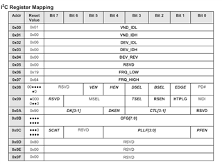

    Internal Register Compatibility: We require compatibility with the existing Sil164 register set for a smooth transition. Can you confirm the level of register compatibility between the TFP410 and Sil164?
    The register are very compatible as seen in the datasheets.
    SIL164
    TFP410
