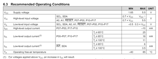

My SDA and SCL line have a 3.3 volts level and my TCA9539 is powered by 1.8 volts. It works but I dont know if there is a risk od damage. The datasheet is not clear if it is aceptable or not. Can you help me? Thanks

    This implementation is fine. The voltage applied to the SDA/SCL pins can be higher than VCC as long as it is below the recommended operating conditions of 5V.

    The recommended operating conditions in the datasheet are below:
    It is recommended to have SDA/SCL only up to VCC. However, note (1) states that if SDA/SCL are above supply, an increase in ICC will result. Although an increase in ICC results, I do not suspect damage to the device unless the voltage on SDA/SCL exceeds that of the absolute maximum conditions.
    The device was also not validated with a voltage on SDA/SCL that is above VCC. Device operation and the electrical characteristics have not been guaranteed by the datasheet in this way, although this implementation will probably work.
