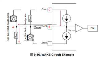

i checked the TCAN1043A-Q1 , I will apply the local wake up pin
when i apply the High side control, I don't understand the meaning of the following formula
The formula is explained in the specification book, but I didn't understand it
As shown in the figure below, if my maximum input voltage is 45V, as described in the specification book, then the voltage at point C in the figure is 45V. So, which point's voltage is 44V? Is it B or C? What is the voltage at point A? Is the direction of the current indicated by the red arrow? Please help explain in detail
thank you
best regards

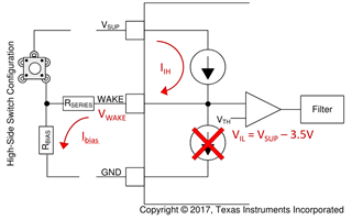

    This formula is meant to ensure that the biasing resistor in a WAKE circuit is strong enough to drive an appropriate voltage at the wake pin even when the adaptive internal bias in providing the opposate bias. For a high-side switch configuration, we need to ensure that the pull-down resistor in series with the series resistor is capable of sinking enough current from the internal pull-up source to make the input voltage at the WAKE pin fall below the low-level input threshold.
    Vwake = Ibias * (Rbias + Rseries)
    Our target Vwake in this case is below low-level input voltage threshold. Assuming that the internal pull-up is active, to Ibias supplied by the transceiver will be IIH. Substituting these in and rearranging the equation to solve for Rbias we get:
    Vwake = Ibias * (Rbias + Rseries) < VIL
    IIH * (Rbias + Rseries) < VIL
    (IIH * Rbias) + (IIH * Rseries) < VIL
    (IIH * Rbias) < VIL - (IIH * Rseries)
    Rbias < (VIL / IIH) - Rseries
    This is different from the form in the datasheet that is for a low-side switch configuration, which may be where some of your confusion is coming from.
    Note that once the transceiver has recognized a low-level input, the internal bias will switch to a pull-down configuration to reduce system power consumption. This will also cause the voltage as the WAKE pin to rest very close to ground potential until the high-side switch is activated.
    Let me know if this is clear and if you have any more questions.
