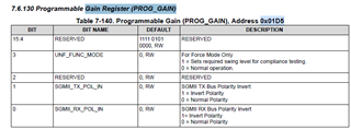

we also try to adjust Gain Register (PROG_GAIN), Reg 0x1D5 = 0xF508 with  RBIAS resistor 11kΩ, and it also gets fail for ethernet compliance test. (Sets required swing level for compliance testing)

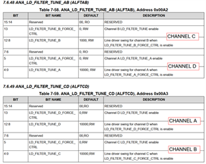

  • Hi, Evan
    Status update, problem solved for 100Mbps.
    But customer feedback (guess), datasheet should be have some context error.
    ANA_LD_FILTER_TUNE_AB is for channel C & D
    ANA_LD_FILTER_TUNE_CD is for channel A & B
    Need you internal confirm.
    Many Thanks
    Gibbs
  • Hi Gibbs,
    Is mirror mode or auto-MDIX enabled in the customer's application? This may re-order the channels and cause confusion with channel-based register tuning.
    Thank you,
    Evan
