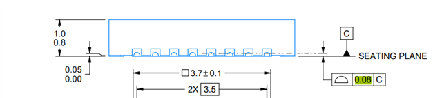

Regarding DS90UB635TRHBTQ1 package VQFN32:
-> in datasheet, the coplanarity is noted as 0.08mm, which is the standard.
Do you have some measurement data regarding this? We wish to know if the "real" value is close to 0.08 or possibly lower 0.07/0.06mm
(Why? As we a high density board with 0201 components very close to the DS90UB635TRHBTQ1, we wish to use a 100µm stencil. Hence, we wish to have more accurate data)
I checked in PPAP20230208-022444 and was not able to find this kind of data
Can you support?
