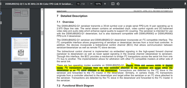

Dear Team ,
We have planned to use DS90UB925QSQE/NOPB [925 and 926 chip] in one of our project ,
as I marked in below image ,
serializer and target either the deserializer or an I 2C slave attached to the deserializer

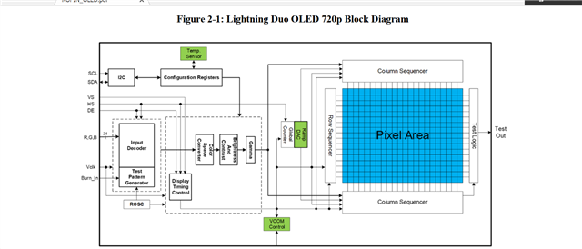

At my case thermal sensor---> FPGA--->Serializer[925]---->Deserializer[926]-------> KopinOLED Display [KCO-D720-DA]
My Question is here
1.FPGA will initiate the I2C communication then it communicated to 925 ,via link 926 is communication will establish
Would I connect 926 I2C to OLED DISPLAY AS directly or should I need to use any micro controller b/w 926 and  KopinOLED Display [KCO-D720-DA]
2  Required Default display mode register setting for DS90UB925QSQE/NOPB
If my understanding  is wrong ,please correct me
*KopinOLED Display [KCO-D720-DA]   block Diagram
