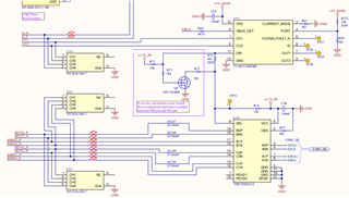

We are trying to use a TUSB321RWBR with a TMUXHS4212 multiplexer, and are running into some issues with orientation and detection.
We have configured the TUSB321 in Host mode by pulling the PORT pin HIGH, and have connected a MOSFET circuit to invert the logic of the DIR pin output to match our configuration of the MUX.

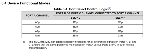

We noticed that the only time that the USB device was recognized by our system is when the SEL pin of the MUX is HIGH, meaning that the pair of SS lines that are being passed through the MUX are the ones that we have accidentally switched the polarity of when connecting to the C ports of the MUX.

  • We are seeing the SEL pin driven low when trying to select the B ports. The VBUS is being fed from a 5V supply in our circuit. This is always on, but if the VBUS has to be enabled after CC negotiation, why would the device only recognize the USB connection when the C ports on the MUX are being selected? Even after the device sees the connection, if the plug is removed and then reinserted in the opposite orientation (i.e. the SEL pin goes from being driven high to driven low), it no longer sees the connection, but comes back after flipping it again.
    The SEL pin of the MUX is going through the MOSFET circuit to invert the logic of the TUSB321 DIR pin output.
    So when SEL is low, C port will be selected. When SEL is high, B port will be selected.
