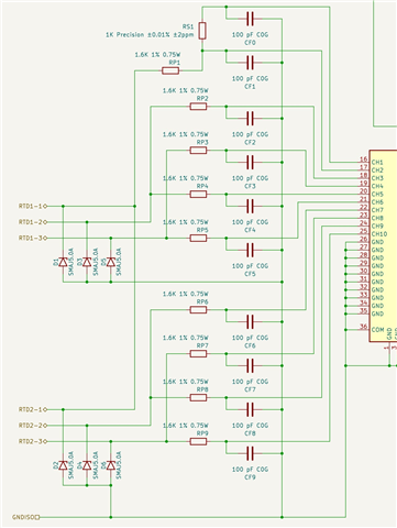

I’m looking for parts / design recommendations to enhance the EMC of our device and to provide it with additional ESD / Surge protection. Currently there is no certification to be achieved, but we would like to implement everything we can to improve the robustness of our devices used in industrial settings where the surrounding electromechanicals are ageing and producing a growing variety of EMI.
Our device measures temperature using a RTD PT100 with 3 wires aiming an accuracy of +-0.1oC. We have our first hardware prototype tested and working pretty well.
However, the RTDs are attached to the device using cables ragging from 3 to about 15 meters. Those cables are the “Coupling Paths” for the “Noise Sources” that affect the Systems like ours according to EMI literature.
In respect to improve the EMC of our devices, we went with the route of implementing TVSs as proposed on this article from ADI which uses the same part we are using as the RTDs frontend, an LTC2986. However, implementing those TVSs the accuracy was affected as the impedance readings increased around 0.8 ohms compared to the devices with no TVSs installed. The conclusion is that the reverse leaking current of 800uA of the SMAJ5.0A is not acceptable.
We came across the TVS0500 whose 70pA Leakage Current at our ambience temp seems to be a huge improvement over the previous part. However, all this theory and devices are pretty new to us and this is where we would like to ask for your help to confirm if the following is correct or not:

Now, considering the IC to be protected, its actual operating voltage is 3.3V and its absolute max on its channels pins is 3.0V 3.6V (I took the liberty to assume that, as the datasheet says it is VDD-0.3 which seems to me like a typo).
Anyway, to determine the max voltage that the protection device should provide, I have learnt from other responses in this forum that the max indicated in the datasheets apply for the continuous DC voltage and it is generally accepted to assume the “peak” max will be higher. The proper way to do determine it is plotting the PLT curve for the device to be protected, but sadly we don’t have the resources to do that. However, we can take as a reference, that so far, none of the 12 channels that we have deployed on the field have failed, all of them with SMAJ5.0A installed and running continuously on the machine with the worst EMI conditions. So we may also assume that the protected ICs are capable of handling 9.2V peaks.
I should explain that while it is normally not expected 24V continuously at the RTDs inputs, we wanted to consider the cases of misconnections and shorts of the system’s power source with the RTDs wiring. We implemented then series resistors between the TVSs and the protected IC. We calculated that those 1.6Kohm resistors at 24VDC will provide at most 15mA which is permitted by the IC on its channels according to its datasheet. It may also be worth to note that the resistors are not affecting negatively the accuracy sensor, which as we have learnt, is a usual compromise in these cases.
All this to say that the voltage permitted in our actual implementation of the IC is not 3.3V but instead 24V, right? Here it is the relevant part of the schematic:

  • Hi Mauricio,
    Thank you for the information.
    1. To answer your first question, I believe TVS0500 should have the right working voltage to protect LTC2986. The only concern I have is that the datasheet for the LTC device is showing a supply voltage range of 2.85 to 5.25V and TVS0500 has a working voltage of 5V. Ideally, you want the TVS working voltage to be at or above the operating voltage. This makes me think a different device might be needed for protection. We have TSD05 which can be a suitable replacement with a working voltage of 5.5V. Also, you are right about the absolute maximum voltage. Typically, IC datasheets will speak the DC voltage while our clamping voltage is a transient voltage which allows for some wiggle room.
    2. I am a bit confused about the 24V, is this to protect for short to battery? Is this something that is going into a car? For now, I would say continue to use a 5V or 5.5V TVS diode for protection because if 24V is used then the diode won't ever turn on unless it is in the short to battery scenario. I will get back to you in a few days on a solution/another team to reach out to for a device.
    3. Technically, yes. If TVS0500 is not suitable then finding a 24V diode will be the next step. But again, I will get back to you on the best course of action.
    4. So the only thing I can think of on the hardware side is using an EMI filter protection diode. We do offer some TPDxF003, which might be worth checking out to see if this could potentially help. Also, I wouldn't recommend using the EMI protection diode and the TVS because the EMI diode offers ESD protection as well.
    Please let me know if you have anymore questions and I will get back to you soon about the short to battery protection.

    Our device is meant to be used in an industrial setting (not in a vehicle). The protection we mentioned related to 24V is to prevent damage if a misconnection happens or in the event any of the RTD leads come in contact with the power source of the rest of the equipment, which is 24VDC. The circuit is based on the section Protection of this ADI article which depicts the Analog Front End we are using, the LTC2986.
    I think our doubts are better rephrased like this:
    • The integrated circuit we want to protect - the LTC2986 - has a rated operating range of 2.85 to 5.25. However, the IC's pins that are in contact with the RTDs (the ones to blame for being conductors of the external EMS/Surges), we have to consider the voltage rating at those pins (not the whole IC’s voltage rating, isn’t it?). As those pins have a rated operating voltage of VDD - 0.3 according to the datasheet, and because VDD in our case is 3.3, then the Vrwm that we have to look for a TVS is 3.0V. Am I correct?
    • However, if we consider the circuit to protect down stream of the RTD connector (not just the IC), and being it able to withstand 24VDC for some time (at least before the over current protection resistors won’t be able to dissipate any more power) and considering that with those resistors and voltage the current at the pins of the IC won’t receive more than the 15mA limit per the IC datasheet, what should be the Vrwm that we have too look for the TVS? is it the IC’s channels pins max 3V or the circuit’s 24VDC?.
    • There is another questions regardless of the above: Can the TVS0500 sustain 24VDC continuously? (Which may happen in a misconnection).
    However, after consideration in our part, we concluded that any EMI / ESD protection is more important for us than the “continuous” 24VDC protection as it is expected more events of the former than the latter. So if it is necessary to accommodate, we can drop the 24VDC requirement. I should note that we will always have the protection resistors on the design, as those are needed along the capacitors to provide also a low pass filter to attenuate frequencies and those resistors will also provide at least 5VDC protection.
    Then, the new low for the "operating voltage" would be 5VDC in this hypothetical case. However, that's higher than the 3.0 operating voltage of the channels of the LTC2986 that are in contact with the leads of the RTDs. Would it be a problem having that 2V window related to the Vrwm of the TVS?.
    TI has “Normal” TVSs with Vrwm of 3.3V, But I appreciate better the “Flat-Clamp” counterparts. As you mention, the later also offers ESD protection, and those 70 pA of leaking current are really appealing compared to the effect of ordinary TVS on the integrity of our signal. However being 5V the Vrwm of the TVS0500, I wonder if in our circuit that would be a problem.
    The TVS is recommended to have a slightly higher Vrwm than the operating voltage, meaning if the operating voltage is 3.3V then we could recommend a 3.6V device.
    TVS diodes are not designed to take a constant voltage above the breakdown voltage for periods of over a few micro-seconds. It may be possible to use some other component (such as a capacitor, Zener Diode, Schottky Diode, etc.) to help with the over-voltage protection. I will investigate this with our team and see if I can find a good recommendation. As we specialize in transient protection, we do not have devices in our product line geared for these constant over-voltage events. A TVS should be able to be used in parallel with any over-voltage protection option, allowing for both types of protection, but I would recommend testing this to ensure feasibility.
    I apologize, I do not fully understand where this 5V protection is coming from. If this voltage increase is after the RTD (and the protection on the output of the RTD), then there is no problem with this voltage difference. If this 5V operating voltage is being shifted to before the TVS device then there would be issues depending on the breakdown voltage of the TVS being used.
    I do agree, if the working voltage of the line that we are trying to protect is 3.3V, using a 5V device is not optimal. Unfortunately, we do not currently have a 3V flat-clamp device, but we do have many other high surge-rated 3.6V devices, specifically our ESDS31x family. This family has a few options to choose from in channel count, capacitance, and clamping voltage. Would these devices be of interest to you?

    I think I have found a very valuable resource from TI that address the issues on my original post. There is a presentation here https://www.ti.com/video/6216801464001 by Art Kay that covers the case for the 3 Wire RTDs circuits based on this: https://www.ti.com/lit/an/sbaa547/sbaa547.pdf by Dale Li.
    it seems that I was missing the keyword "EOS immunity" (Electrical overstress) to find the relevant resources. The material  illustrates the cases like the continuous voltages caused by misconnections we were interested on and presents a nice clarification for me about the working voltage of the circuit.
