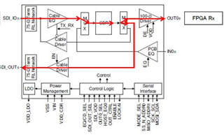

In the LMH0397 datasheet, the following is written in the OUT- and OUT+ terminals of pins 22 and 23 under Pin Functions.
Differential outputs to host video processor. On-chip 100-Ω differential termination.
Requires external 4.7-µF, AC-coupling capacitors for SMPTE applications.
We use the LMH0397 in SMPTE applications.
It says "4.7μF AC coupling is required," but if there are no problems with the device receiving this signal, would DC coupling be okay?
I think they just want to say that if you are AC-coupling in SMPTE applications, you need a capacitor of 4.7μ or more, but I would like to confirm just to be sure.

    A large AC coupling capacitor (4.7 µF) is typically used in transporting SDI serial bit stream to avoid low frequency DC wander. The idea is that SMPTE uses this large AC coupling cap to ensure that the bit stream has a heavy DC unbalance.
    DC wander can be detrimental to the bit stream, so it is recommended to not DC couple and use the 4.7uF cap on the OUT- and OUT+ pins.

    AC coupling is recommended, but it is good to note that DC wander occurs from AC coupling. The capacitor value of 4.7uF is our recommended value that optimizes a combination of minimizing DC wander while maintaining AC coupling.

    I have one additional question. I am using the LMH0397 with the following internal route.
    HD-SDI (1.485Gbps) is connected to the "Rear SDI IN". A waveform monitor is connected to the "Rear SDI OUT" to observe the eye pattern.
    There seems to be no problem if I connect a signal source to the LMH0397 input via a short cable, but if I use a long cable (5C-FB cable 140m), the CDR seems to stop working.
    Is there any register setting that needs to be done to enable the CDR to lock when using this long cable (= input signal attenuated)?

    Unfortunately, our register/resistors controls affect the signal after being relocked by the CDR. If the CDR is not able to lock to the incoming signal, it is too attenuated to work with at all.
